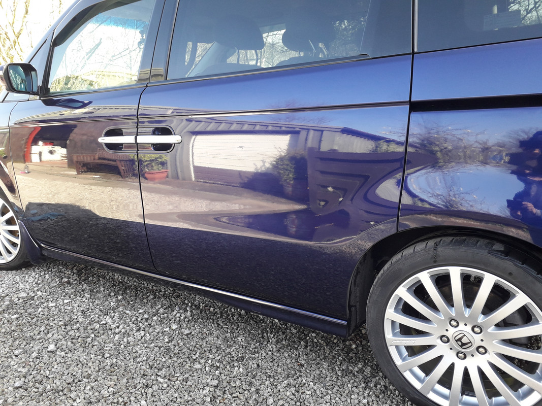

Moderators PTR200S Posted March 26, 2020 Author Moderators Report Share Posted March 26, 2020 Today was clean up the van day, well the outside at least... as you have probably seen in the dirty vehicle thread it gets pretty bad !! After a good wash I though I would hit it with the wet wax, quick job and move onto the Coupe... Nope, discovered that the sides , upto about 3 feet off the floor were like sandpaper, covered in spots of tar. Out with the Oblitarate tar remover and after several passes using the stuff on shop towels I manged to get it all off..put some Simoniz wax on after to protect it a bit as the tar remover removes EVERYTHING off the paint !! Looks pretty reasonable now...plenty of time to do more to it...all of the lockdown time actually !! 3 1 Link to comment Share on other sites More sharing options...
