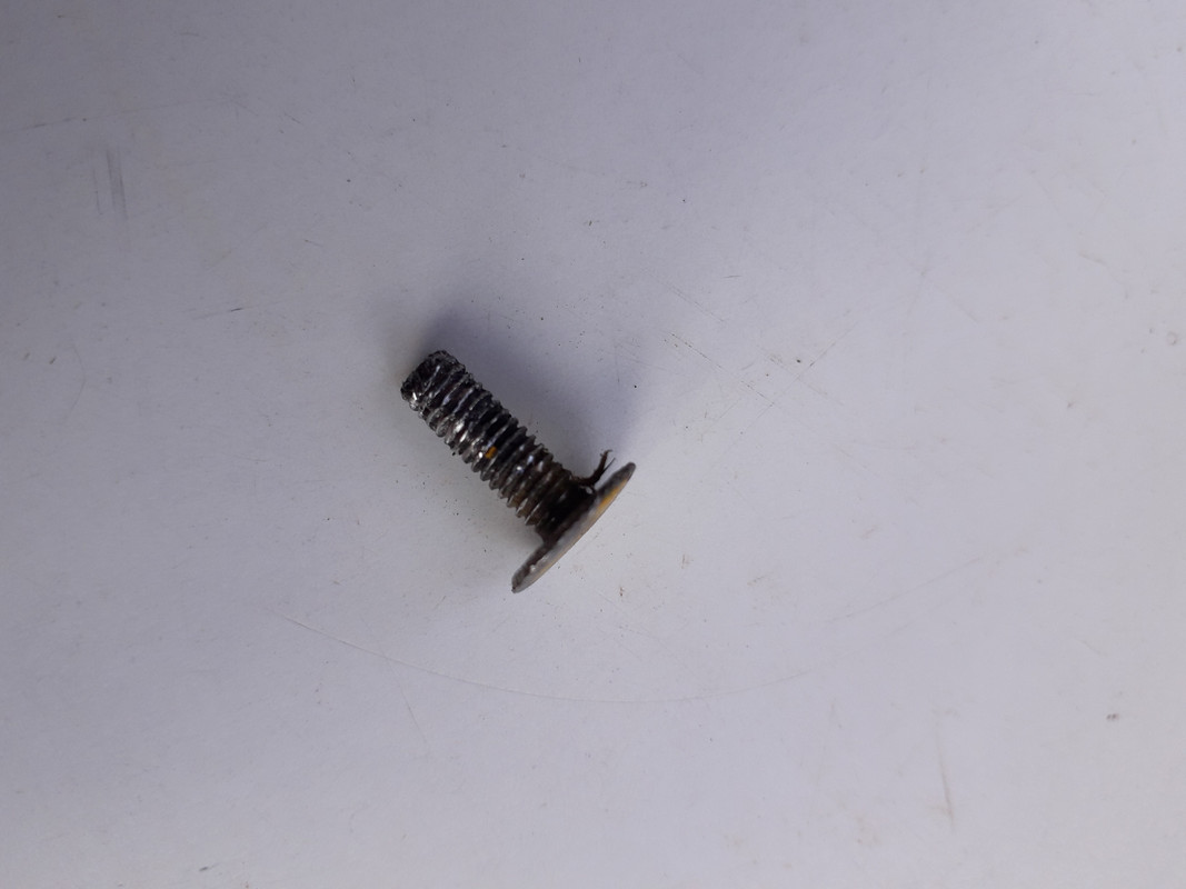

Moderators PTR200S Posted May 21, 2019 Author Moderators Report Share Posted May 21, 2019 Here is the puncture culprit, not a roofing nail after all, (definitely looked like it !).... appears to be a crosshead set screw in a previous life. possibly a small diameter roofing bolt.......how it managed to go vertically, at right angles, into the tyre is strange... Tyre fixed using a proper mushroom head rubber plug.... from the inside obviously !! 3 Link to comment Share on other sites More sharing options...
Moderators Laird_Scooby Posted May 21, 2019 Moderators Report Share Posted May 21, 2019 Rubber mushrooms beat metal mushrooms in this case! Glad you got it sorted Pete! 2 1 Link to comment Share on other sites More sharing options...

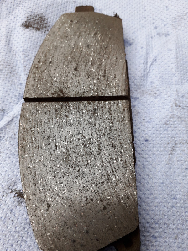

Moderators PTR200S Posted July 27, 2019 Author Moderators Report Share Posted July 27, 2019 Managed to get nearside front wheel and caliper off this morning before I got rained off ⛈️🙄 The caliper bolts are rust free and undid easily . The slider pins are free and easy, pad ears free from crap and corrosion... Pads down to less than 5mm but clean, disk is good with minimal lip but does have "plucked" look to it. Pad has probably been stuck in the past sometime, maybe whilst sat on the docks waiting for export. Definitely looks beaten up but in theory still usable. Rain stopped play before the disk runout check... another day methinks...... 1 Link to comment Share on other sites More sharing options...

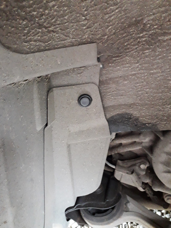

Moderators PTR200S Posted July 27, 2019 Author Moderators Report Share Posted July 27, 2019 Also found yet another fastener missing from the wheelarch under liner...why don't people just do the job properly and put them back ?? arrrgggghhhh You can see the wear marks on the inner arch where it has been flapping back and forth, the only thing holding it on is lower down under the front crossmember. Couple of seconds and its in !! 3 Link to comment Share on other sites More sharing options...
Moderators PTR200S Posted July 28, 2019 Author Moderators Report Share Posted July 28, 2019 The disk thickness is down to about 20 thou short of 28mm.. i believe the nominal thickness new is 29mm so these disks should clean up. As the rain is now coming down in biblical proportions and has been doing for some 36 hours operations have switched to finishing the Ark . Oh, and a bit of migging on a mates cock and rake.....😲.....indoor jobs !!! Might wash the Elysion too......🌊 2 Link to comment Share on other sites More sharing options...

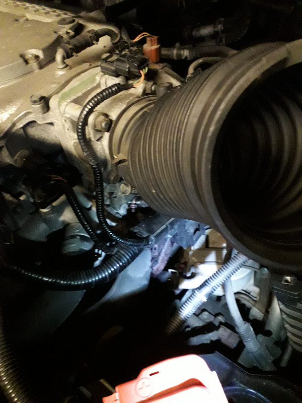

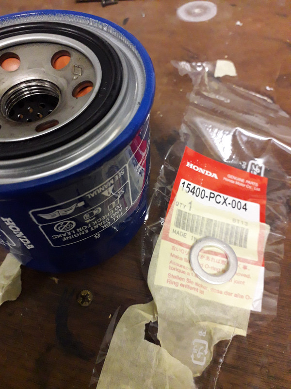

Moderators PTR200S Posted September 5, 2019 Author Moderators Report Share Posted September 5, 2019 Got in from work , off until Tuesday now so thought I should get on with those jobs that keep getting put off !! That coolant leak for a start and as I have to take the air intake / filter unit off then I can also get to the gearbox filler cap at the same time which means another transmission oil part change wants doing ! As I am underneath it would be rude not to do an oil and filter change too, so that is the first job as the oil is hot... New Honda filter to go and I am contemplating trying magnatec this time. Off with the engine cover first followed by the battery out. Then dismantle the air intake from filter to throttle body to give enough space to get a 17mm socket on a 12 inch bar onto the gearbox filler bolt. Always check to make sure you can get this filler bolt out BEFORE you drain the oil the atf !!! It took some shifting, had to resort to a long bar to crack the bolt. As I have some chores at home to do these jobs will get done over the next couple of days. Pics to follow 😃 1 Link to comment Share on other sites More sharing options...

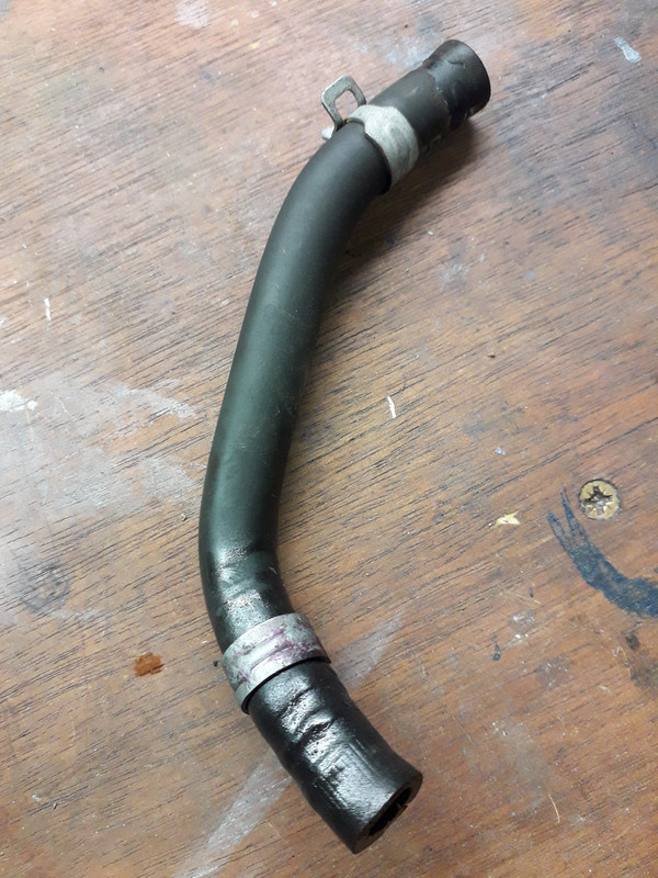

Moderators PTR200S Posted September 6, 2019 Author Moderators Report Share Posted September 6, 2019 Shiny new filter, correct type !!! mated with magnatec to test .. Here is the offending leak of coolant, all that pink stuff has dropped off an 5/16th id hose about 5 inches long connecting the air intake to the throttle valve. The connection is on the throttle valve lower and runs up behind the intake hose and connects to a dual flow and return pipe behind the engine, bugger to get at. Here it is, the hose is rock 'ard !!! Whilst all this lot is out I can get to the filler for the gearbox, the big 17mm cap nut you can see in this pic, right down in the bowels at the back of the engine compartment...bearing in mind that this is a van and the engine sits partially under the bulkhead 😛 3 Link to comment Share on other sites More sharing options...

Moderators PTR200S Posted September 6, 2019 Author Moderators Report Share Posted September 6, 2019 New coolant pipe and clips... obviously cut to fit !! The old one is next to the new one here but is really hard and "welded" into the shape you see !! Definitely would not have been like that when you see the proximity of the connections... 3 Link to comment Share on other sites More sharing options...
Administrators hughezee Posted September 6, 2019 Administrators Report Share Posted September 6, 2019 Great work Pete 👍 me personally I gave up on trying to replace OEM hoses with aftermarket and replicate bends, waste of my time IMO. When I did it on the odyssey once they warmed up they would kink and restrict flow even with a reinforced hose... 😮 Sometimes you can get away with it with extra length of pipe but then it rubbed against too many metal surfaces or parts for me to confidently leave it... 4 Link to comment Share on other sites More sharing options...
Moderators PTR200S Posted September 6, 2019 Author Moderators Report Share Posted September 6, 2019 I know what you mean re original stuff and i would replace it if i could but there are none like this in the country. I need the van on Tuesday so needs must ! The good news is that the hose does not touch or interfere with anything else so i should get away with it, still trying to track a proper part number as Cox Honda can probably get it. Andy at Cox will be on case Monday !! 3 Link to comment Share on other sites More sharing options...
Moderators PTR200S Posted September 7, 2019 Author Moderators Report Share Posted September 7, 2019 Well Elly is all back together , i just hope that the coolant leak is from the pipe because i found some corrosion on the connector elbow on the throttle pot..tested it to full heat and no leaks but it needs fully testing this next week to make sure. Gearbox smooth on downshifts now, just over 3 litres of atf used on the part change so another change in a few months. 3 Link to comment Share on other sites More sharing options...
