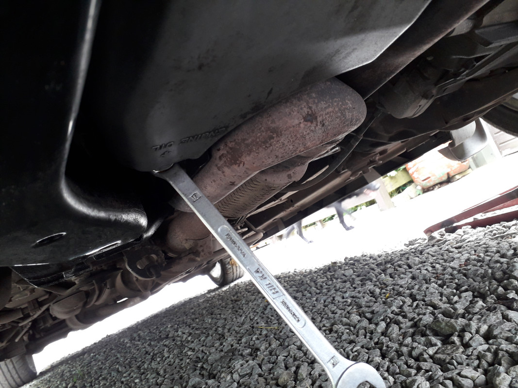

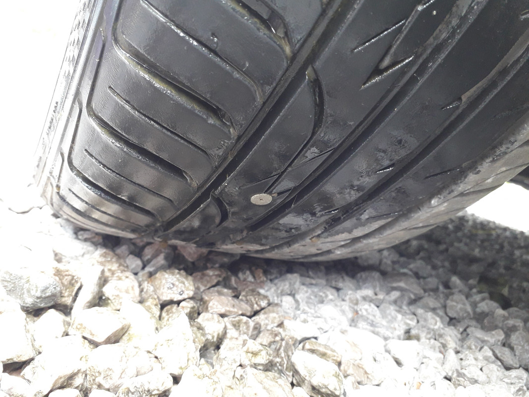

Moderators PTR200S Posted May 18, 2019 Author Moderators Report Share Posted May 18, 2019 Today was oil change day for Elly, plus an investigation on a front nearside tyre pressure drop.... Up the ramps to give some clearance, the van sits low and the front spoiler limits access, 17mm spanner on to the drain plug which faces to the rear of the van ! Thanks Honda !🙄 Blimey, that's a bit dirty..... Put this stuff in to try out, its a bit quieter on tickover..... Investigation of the front nearside tyre revealed this , 😭 barsteward ! 1 1 1 1 Link to comment Share on other sites More sharing options...
Moderators Laird_Scooby Posted May 18, 2019 Moderators Report Share Posted May 18, 2019 1 hour ago, PTR200S said: Investigation of the front nearside tyre revealed this , 😭 barsteward ! Pardon the pun Pete but you've nailed it with the diagnosis. Luckily in the middle of the tread like that it's fixable. Looks like a fairly new tyre too? 1 1 Link to comment Share on other sites More sharing options...
Administrators hughezee Posted May 18, 2019 Administrators Report Share Posted May 18, 2019 I would be surprised if a pin is the culprit of the persistent air loss TBH, might be worth re-seating the valve, still hope it is an easy fix Pete 3 Link to comment Share on other sites More sharing options...
Moderators PTR200S Posted May 18, 2019 Author Moderators Report Share Posted May 18, 2019 1 hour ago, Laird_Scooby said: Pardon the pun Pete but you've nailed it with the diagnosis. Luckily in the middle of the tread like that it's fixable. Looks like a fairly new tyre too? Quite right, best place for a repair and , yes, the tyre is just 12 months old.....fitted by the importer. All four actually but not a brand I would choose and certainly won't at the head of the queue come replacement time !!! 3 Link to comment Share on other sites More sharing options...
Moderators Laird_Scooby Posted May 18, 2019 Moderators Report Share Posted May 18, 2019 I thought it looked like a roofing nail Stu, they can give a persistent but slow air loss. The valve core might be another option or as i had on the Sterling, corroded bead area on the wheel. Didn't even need to peel the lacquer off once the tyre was removed, just touched it and it all fell off leaving a corroded surface on the wheel where the tyre seats/beads. It's now been refurbished but the paint was diabolical so needs stripping down and repainting with different paint. Complete nuisance with a capital "F" to be honest! 2 Link to comment Share on other sites More sharing options...

Moderators PTR200S Posted May 18, 2019 Author Moderators Report Share Posted May 18, 2019 50 minutes ago, hughezee said: I would be surprised if a pin is the culprit of the persistent air loss TBH, might be worth re-seating the valve, still hope it is an easy fix Pete I certainly hope not, Stu, these were new wheels and tyres but definitely will replace the valve when tyre comes off just to be sure. The "pin" is actually a galvanised roofing nail, just doesn't look that big on a big tyre !!! Photo doesn't show it too well to be fair. 2 Link to comment Share on other sites More sharing options...

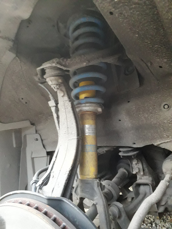

Moderators PTR200S Posted May 19, 2019 Author Moderators Report Share Posted May 19, 2019 Tonights quick job, get wheel off ready to drop tomorrow morning at local tyre place....NOT Kwik Sh!t !!!! Getting the quicklifter under the old girls skirts and onto to her lifting point took some fiddling around.... erm, that' doesn't really read correctly, does it? !🙄 Must get the hub greased up too..... and a bath might just be in order too...... and a quick shot under her arches, mmmmmm 2 Link to comment Share on other sites More sharing options...
