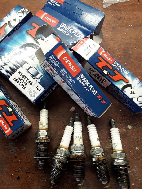

Administrators hughezee Posted August 12, 2017 Author Administrators Report Share Posted August 12, 2017 Well I managed to sneak in a quick plug swap before I lost the light and I am not too sure what to make of these new Denso TT's, my hearing is very sensitive as some of you may know I'm into my audio quality and my coupes sweet smooth cold start audio track has changed dramatically I shall follow up when its back on the road performance wise and obviously the emissions test result from the MOT. So in the meantime here are a few shots of the old and new plugs, ignore the discolouration on the threads as this is what's left of the anti seize and the plugs came out simply like a hot knife through butter. One of the old NGK iridium plugs, despite appearances it's actually super clean as used spark plugs go. 1 Link to comment Share on other sites More sharing options...

Administrators hughezee Posted August 12, 2017 Author Administrators Report Share Posted August 12, 2017 32 minutes ago, Laird_Scooby said: The old ones look good Stu - reading between the lines what you heard hasn't pleased you? In one way No and another Yes but that could just be the honey moon period, fitted plenty of the equivalent standard NGK's and few sets of Denso Iridium's and only ever noticed a full on improvement over old plugs. Like I said think it only fair to report when they have a few miles on them, although kinda think I should retrieve my old plugs out of the bin now. 1 Link to comment Share on other sites More sharing options...

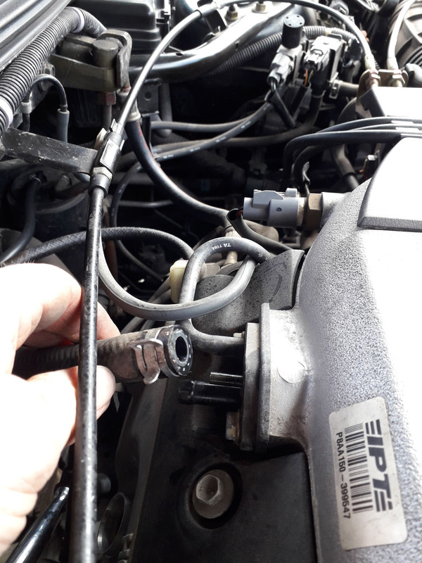

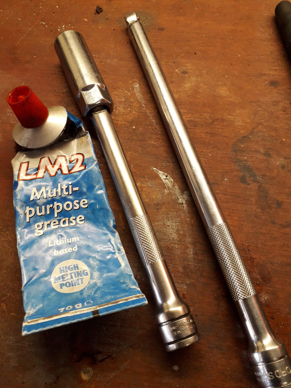

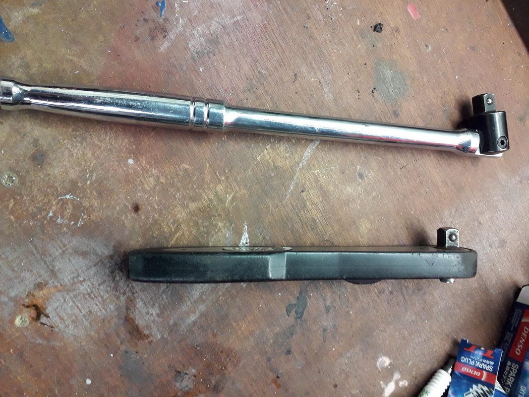

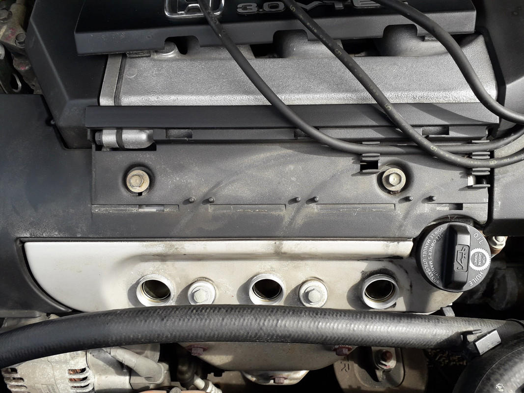

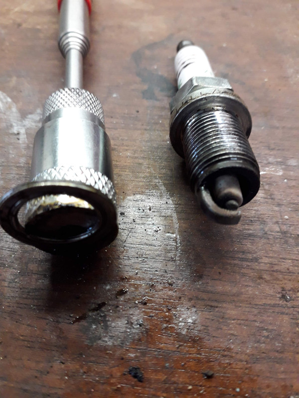

Moderators PTR200S Posted April 13, 2021 Moderators Report Share Posted April 13, 2021 Well that was entertaining ! The plugs haven't been out for a while I guess, started with a ratchet and ended up using a breaker bar !! 3/8ths though, not a scaffold pipe !! Front cover off first then out with the front plug leads, leaving the rear ones until last !! I squirted some release fluid, Ferresol, down the plugholes too, after encountering the first rock shit tight one.. ummmmm. Long extension bar for the front ones so I can get around the pipework...short one for the rear plugs as access is limited....grease for the plug threads...small amount ! The rear ones were firkin tight barstewards, the crack when they let go was something else ! The very last one nearest the brake servo is a really awkward one to get too and as I needed the leverage I removed the vac pipes from the rocker cover, The servo etc. The very last plug also decided to lose its metal washer as I took it out, you know the score ! Managed to hook it off the bottom of the hole, it was stuck to the head, and then retrieved it with a magnetic thingamajig.... Didn't look too bad but obviously not been out for a while... Beginning to leak at the ceramic / metal interface but generally burning well, NGK ones... installed the Denso and she fired first time running smoothly... Job done. 2 1 Link to comment Share on other sites More sharing options...

Moderators Laird_Scooby Posted April 13, 2021 Moderators Report Share Posted April 13, 2021 11 minutes ago, PTR200S said: Didn't look too bad but obviously not been out for a while... Beginning to leak at the ceramic / metal interface but generally burning well, NGK ones... installed the Denso and she fired first time running smoothly... Those gaps are looking somewhat on the large side Pete! Have you measured them at all? 2 Link to comment Share on other sites More sharing options...
Moderators PTR200S Posted April 13, 2021 Moderators Report Share Posted April 13, 2021 3 minutes ago, Laird_Scooby said: Those gaps are looking somewhat on the large side Pete! Have you measured them at all? Yes, I did actually !! The old plugs are about .040 within the spec for this engine, I also checked the new ones .0375....left them at that....soon blow the ends off !! 1 1 Link to comment Share on other sites More sharing options...
