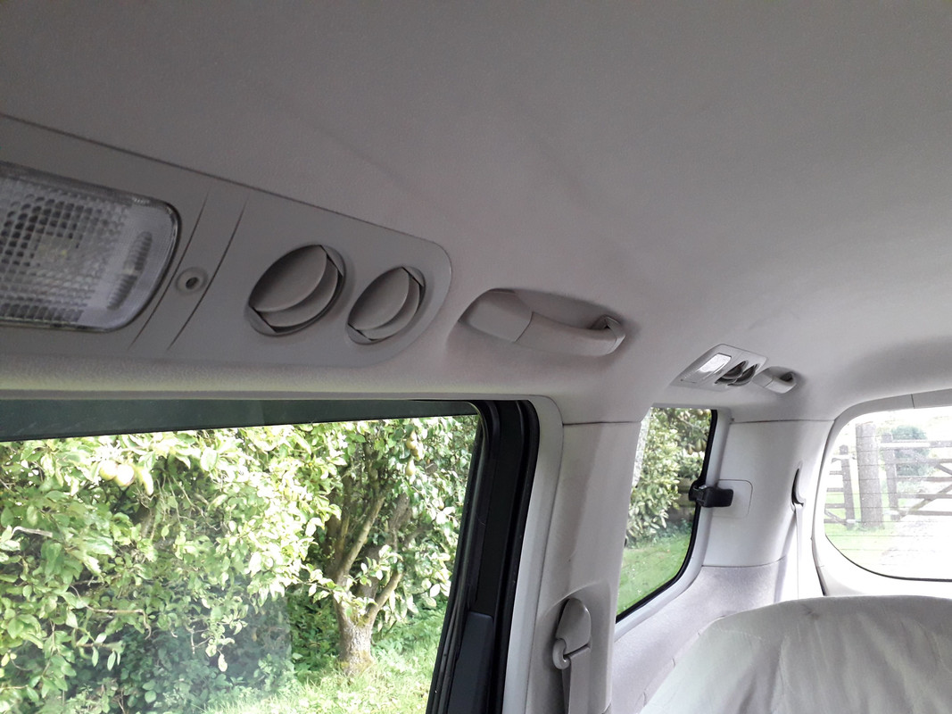

Moderators PTR200S Posted September 10, 2021 Author Moderators Report Share Posted September 10, 2021 They did used to blow as complaints from rear passengers will testify!!! I can wind up the system in manual mode and it will blow from the floor vents but not at the head height vents. Bear in mind this is a separate heating and aircon system operating in the rear of the Elysion. It's controlled off the dash display or off a roof mounted display behind the front seats accessible by the passengers in the second row of seating. Pics...... I will try and get posted tomorrow . 1 Link to comment Share on other sites More sharing options...
Moderators Laird_Scooby Posted September 10, 2021 Moderators Report Share Posted September 10, 2021 Can they be manually turned off by s thumb wheel or similar? I'm wondering if some rear passenger has discovered that function and disabled them. 1 Link to comment Share on other sites More sharing options...
Moderators PTR200S Posted September 11, 2021 Author Moderators Report Share Posted September 11, 2021 No, they are turned on /off using the display controls but the vent can be closed off or restrict the airflow in the same way as dashboard vents, as you can see in the pics, two vents per bank, two banks per side of the vehicle above head height...... 1 Link to comment Share on other sites More sharing options...

Moderators PTR200S Posted October 25, 2021 Author Moderators Report Share Posted October 25, 2021 Finally got around to checking this yesterday..... Fired engine up, decided to select the rear heating / cooling requirements from the rear cabin overhead console....on full aircon auto it seemed to dribble air, as expected, so selected mode version and overhead vents...wtf !!! Blowing like a good un !!!! Went back to front console , selected rear cabin, all info had transferred to display and was able to select and reselect the aircraft vents at will... No idea what's going on but back to normal now !!! 1 Link to comment Share on other sites More sharing options...
